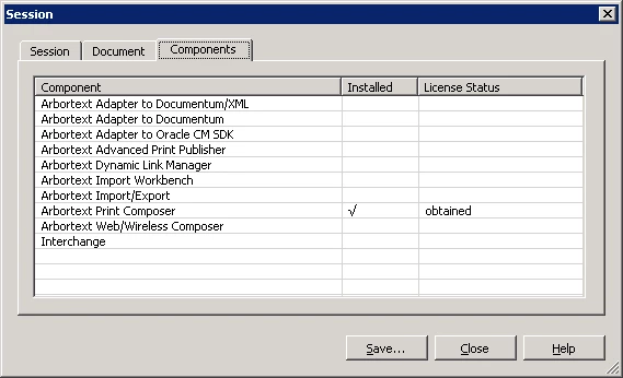

    Just to confirm, you are not trying to use a Publishing Engine
    instance, right? So, you have a properly-licensed copy of either
    Styler or Print Composer? You can check that the licensing is all
    correct through the menus in Editor by going to "Help", "About
    Arbortext Editor", "Session" and selecting the "Components" tab of the
    resulting dialog.

    Jun 15, 2011 11:27 AM UTC
    Even if you have Print Composer installed, you must still set usedistiller=on in order to "un-gray" the Compose-PDF menu selection.
    Jun 15, 2011 4:02 PM UTC
    True. A license for just Print Compose still requires Adobe
    Distiller. However, a license for the full version of Styler removes
    that requirement, as it includes the Direct PDF feature.
    -Brandon 🙂
    Jun 15, 2011 4:09 PM UTC
    And, with AE 5.4 you don't need a Styler license to compose direct to PDF. Just a print composer license.
