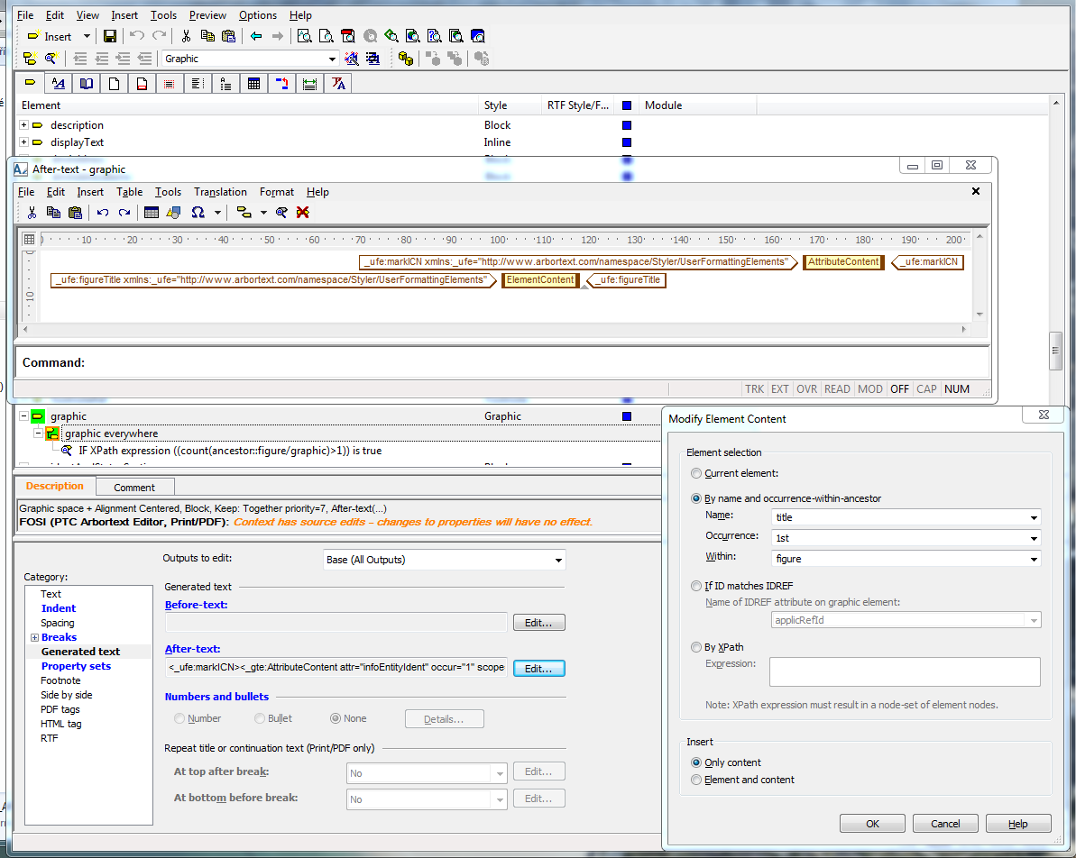

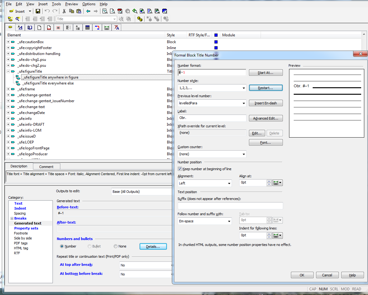

    rkarlík12-AmethystAuthor
    Mar 6, 2015 6:24 AM UTC
    XML structure:
    <levelledPara>
    <figure>
    <title></title>
    <graphic></graphic>
    <graphic></graphic>
    </figure>
    </levelledPara>
    Counted element is </_ufe:figureTitle> pseudo-element inside </graphic> element. Reset is provided in each top chapter (</levelledPara> element).graphic-element.pngpseudo-element.png
    Mar 13, 2015 7:39 PM UTC
    Hi Richard. Two things you want to keep in mind:
    1) You may want to create a separate context for the sheet graphics, so you can keep track of them. Then, you can set the numbering to start on the 1st graphic within figure, and have the other graphic elements within the figure not increment.
    2) I noticed that the element highlighted in your Styler screenshot has source edits. Please remember, once you make a change to an element using source edits, no further changes to that element can be made within the Styler interface. They just won't work. Make sure you do source edits last.
