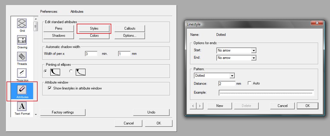

    1. Close all active documents in a window. Then go to "Edit" -> "Preferences" -> "Attributes" -> "Styles":

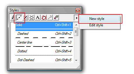

    2. In active document. Go to "Window" -> "Show attribute window" -> "Styles" -> "New style":
