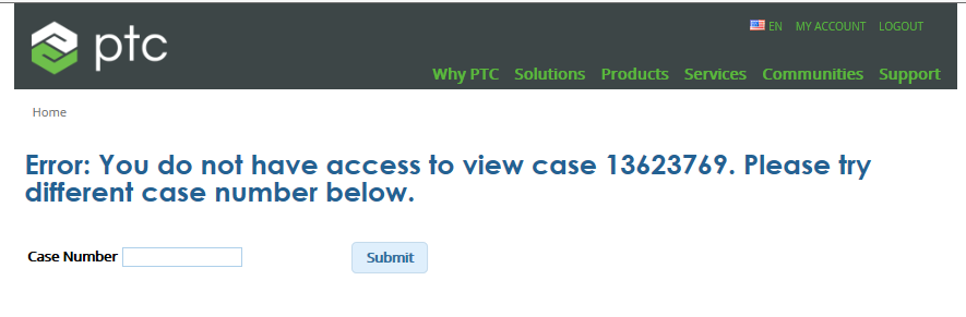

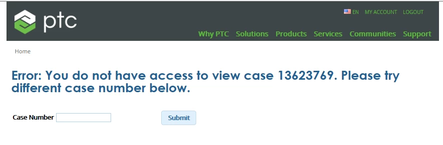

Apr 5, 2017 8:14 AM UTC
Access is denied to me.
