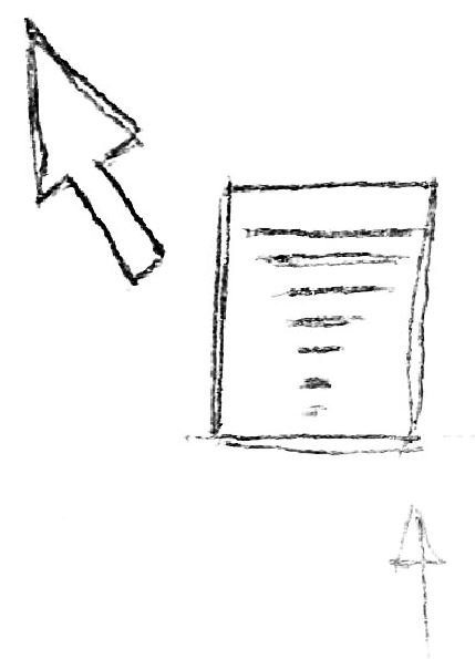

Creo Illustrate Mystery Icon
When this icon appears it disallows many functions within Creo Illustrate. Anyone know what it means?
Aug 8, 2016 12:45 PM UTC
Is that a sketch of it or the actual Glyph? It looks kind of like your Item List icon.
Nov 29, 2018 4:05 PM UTC
Did you ever determine what this icon was?  I too am experiencing it when trying to transform some objects in Creo illustrate 4.1.  I haven't been able to figure out what's causing it, or how to let it allow me to transform.
Nov 29, 2018 4:39 PM UTC
@Dannerj
Your smart filter is on in the lower right.
