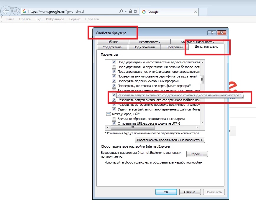

Hi Patrik,
You need to activate the following settings in IE browser (rough name of tabs "Browser settings" --> "Additionally" --> "Security" --> "Allow ActiveX content to run files on my computer"):

Hi Patrik,
