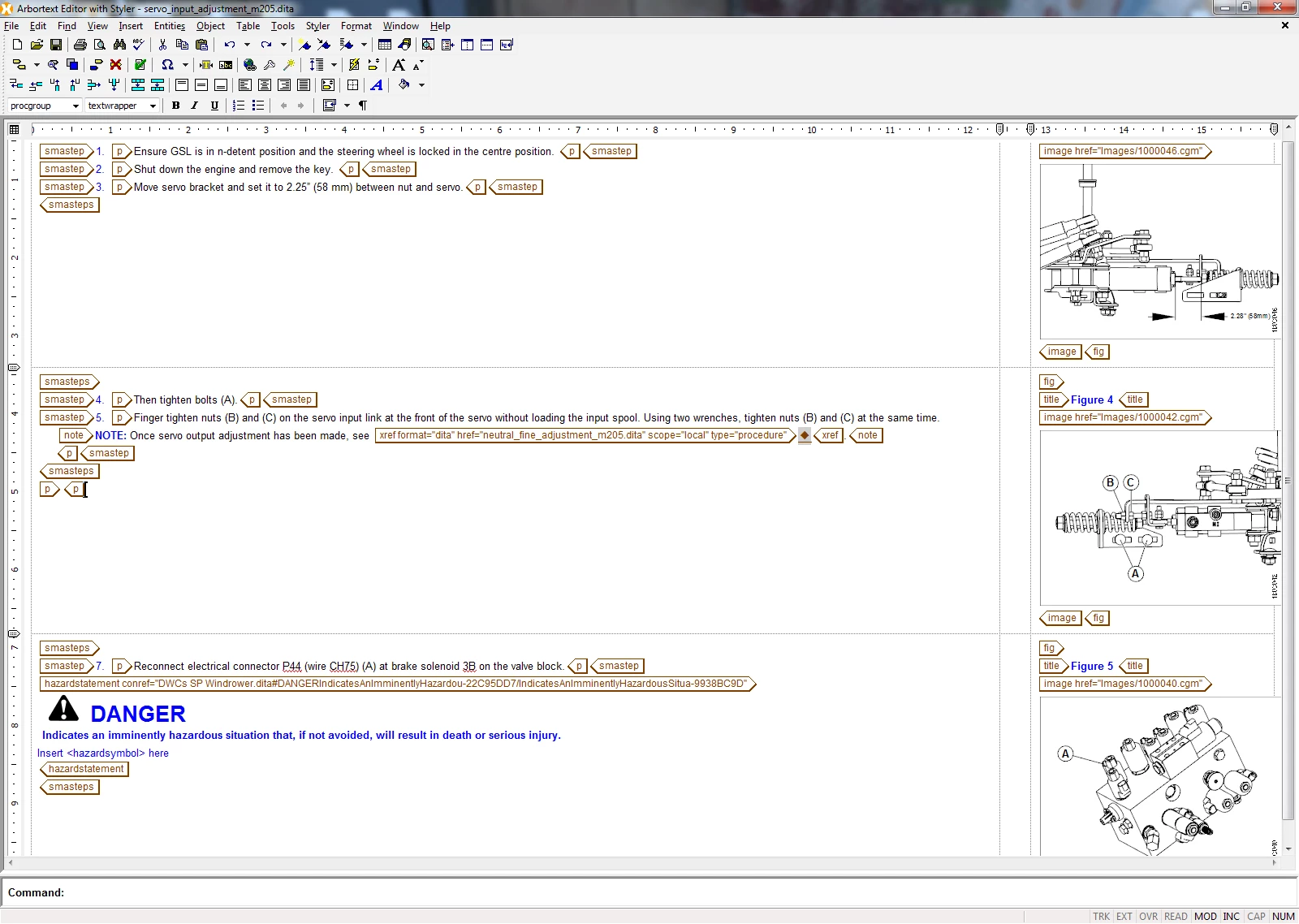

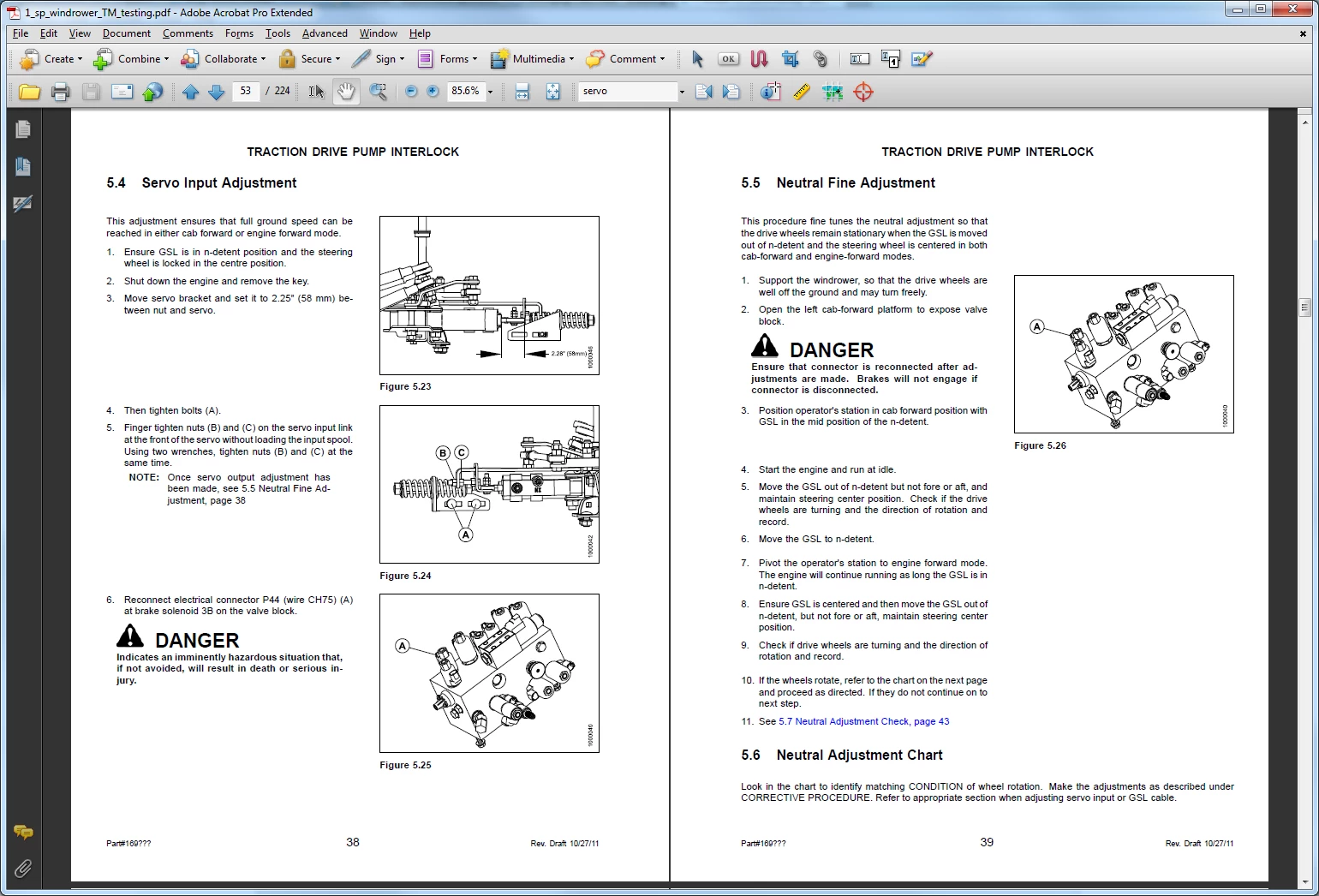

I have a cross reference that does not show up as gentext in a note in my sma side by side procedure. Is this the way it should be. It does show up in the pdf but it is not a blue hyperlink. Is this an issue with the program or the user?

    Bryon, are you observing the issue with Out-Of-The-Box template? On my side with OOTB templates xref within a note shows OK in the PDF (i.e. it's a hyperlink and it's blue).
    Also, this could be an issue with particular procedure. If you xref this particular procedure outside of Note, are you getting correct/expected results?
    Looking at the sma side by side.jpg I see "incorrect" behaviour - you're not getting the title of the referenced procedure resolved. Does it happen with this aprticular procedure only?
    If you're using non-OOTB template, I'd say 99% the cause lies within template. Shouldn't be hard to pinpoint it.

    We are using a customized version of the sma side by side, if I take the xref out of the Note it shows up in blue in arbortext. If I put the xref in the note it does not show upand just has the diamond. If I publsih to pdf, the xref outside the note shows up fine, the one inside the note does not highlight blue. I have two different procedures that it operates the same way in both of them. We currently have a consultant group working on creating our stylesheets. They are almost read to hand them off to us. You are thinking this is apart of the style sheet?
