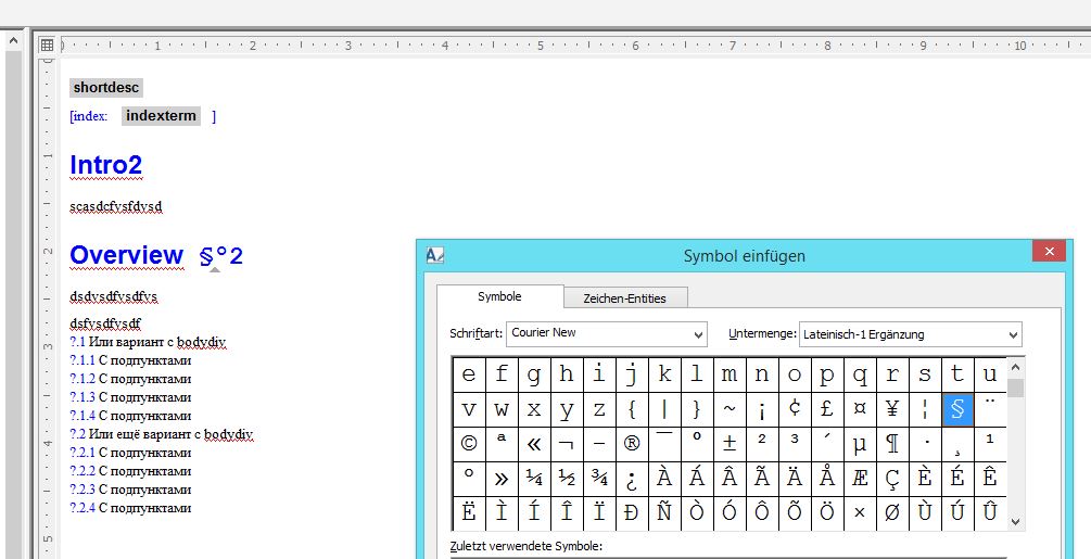

do you know an opportunity to get a 'curl' character like in WinWord instead of space character in Arbortext Editor?
In XML there is an three-per-em space unicode between this characters, like here:
As you can see there is only a space character visible.
In WinWord the useres know this sign:
As you can see there is a curl between the characters.
Is it in Arbortext Editor or Style also possible to get the curl instead of the space character?
Thank you in advance for your help.

Is Insert -> Symbol (Einfügen -> Symbol) what you're looking for?

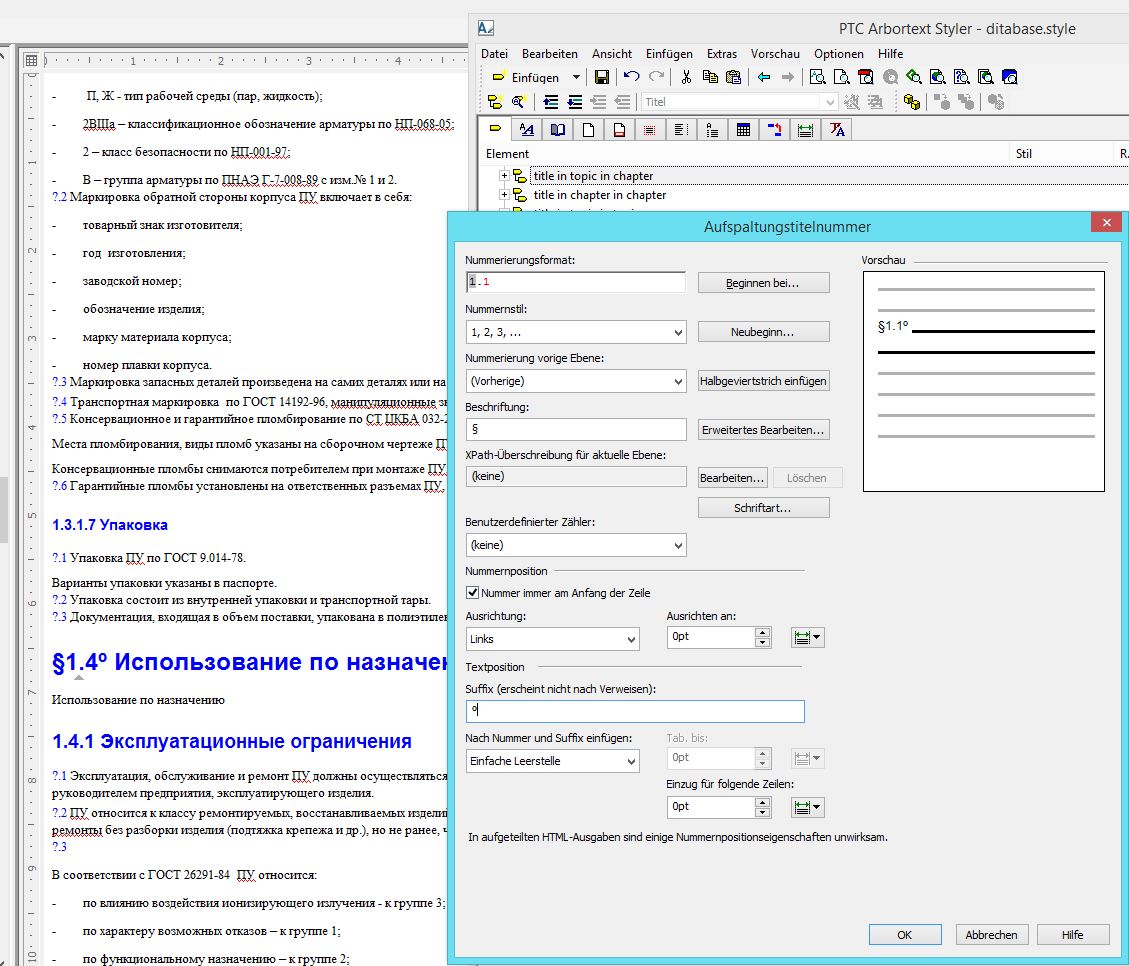

For autonumbering you can use Prefix/Suffix:

thank you for your answer. We dont need autnumbering prefix/suffix. There are many   spaces inside the xml file. We would like to show a curl instead of the space in the Arbortext Editor.
Jul 31, 2014 1:28 PM UTC
Ahh, OK. You should then just edit the <Arbortext>\lib\charent.cf file
