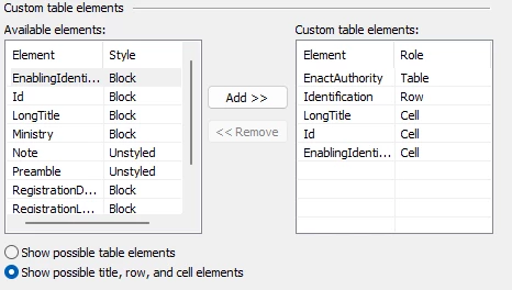

I was able to display my element as a Custom Table by defining Table, Row and Cells  using Arbortext Styler.
Screenshot 2025-02-04 083853.pngScreenshot 2025-02-04 083843.pngScreenshot 2025-02-03 155737.png

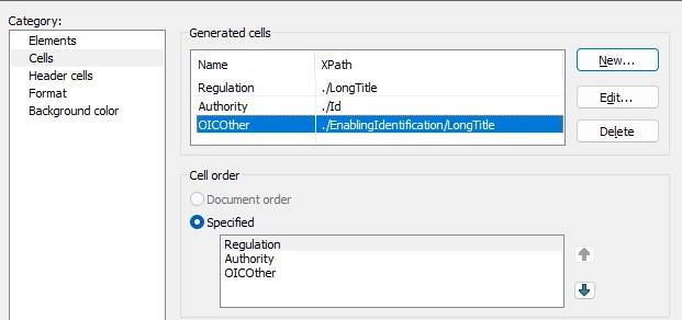

But since I now need to alter the content of the cells, I tried defining Generated Cells using XPath but I never was able to make the content to show.  Here is the configuration I have :

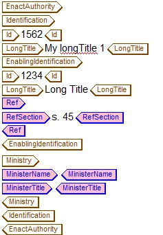

The elements themselves :
Can you explain why I am never able using XPath to generate content cells, this is very crucial for me to being able to do such. Thanks

I think you have a problem with your XPath expressions. When you ask for "/LongTitle", the slash at the beginning indicates you want it to look for that element at the root of the document, not in the current context. If you want to get the LongTitle element as a child of the current element (the Identification element if I'm reading the original post correctly), you should use "./LongTitle" (note the dot before the slash), or simply "LongTitle". So, try rewriting your Regulation expression like this:
concat(string(LongTitle), ' ', string(Id))
