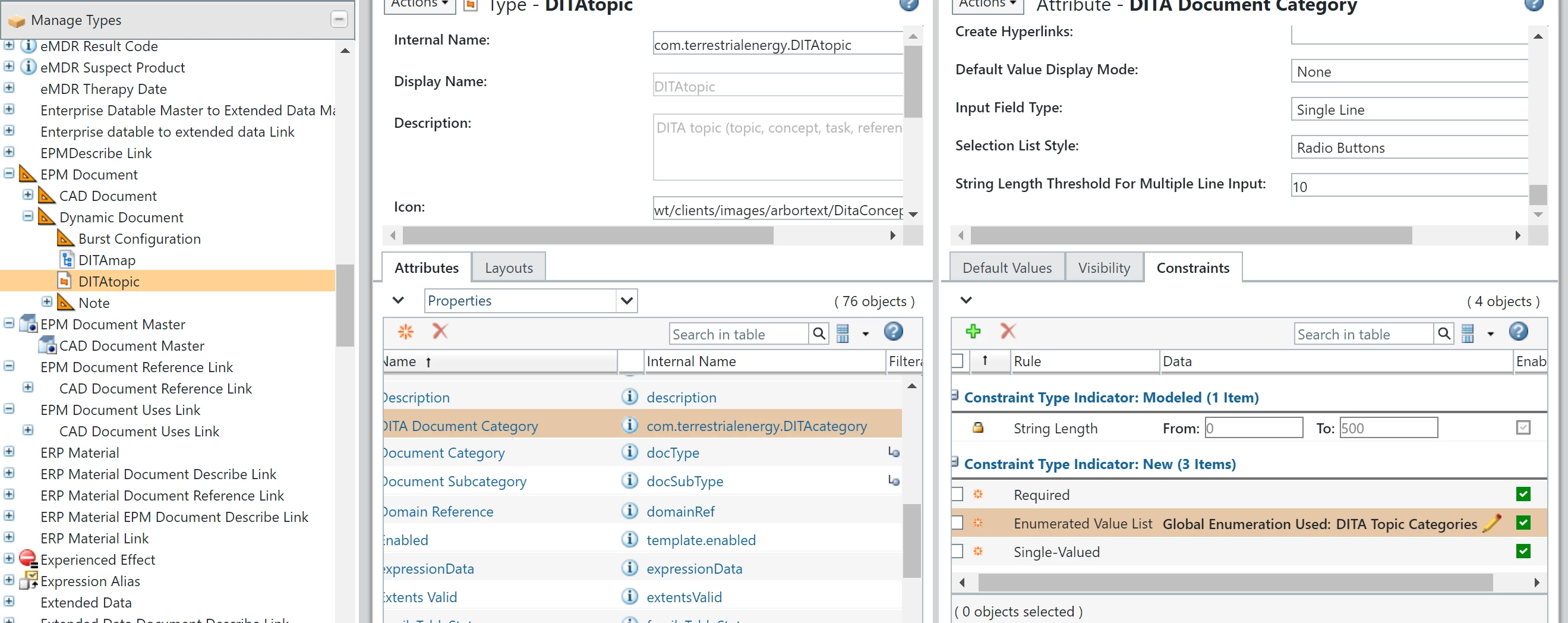

On the site utilities/Type and Attribute Management,
  1. I defined my DITAtopic as an EPM document subtype.
  2. I added the attribute DITAcategory to the DITAtopic subtype..

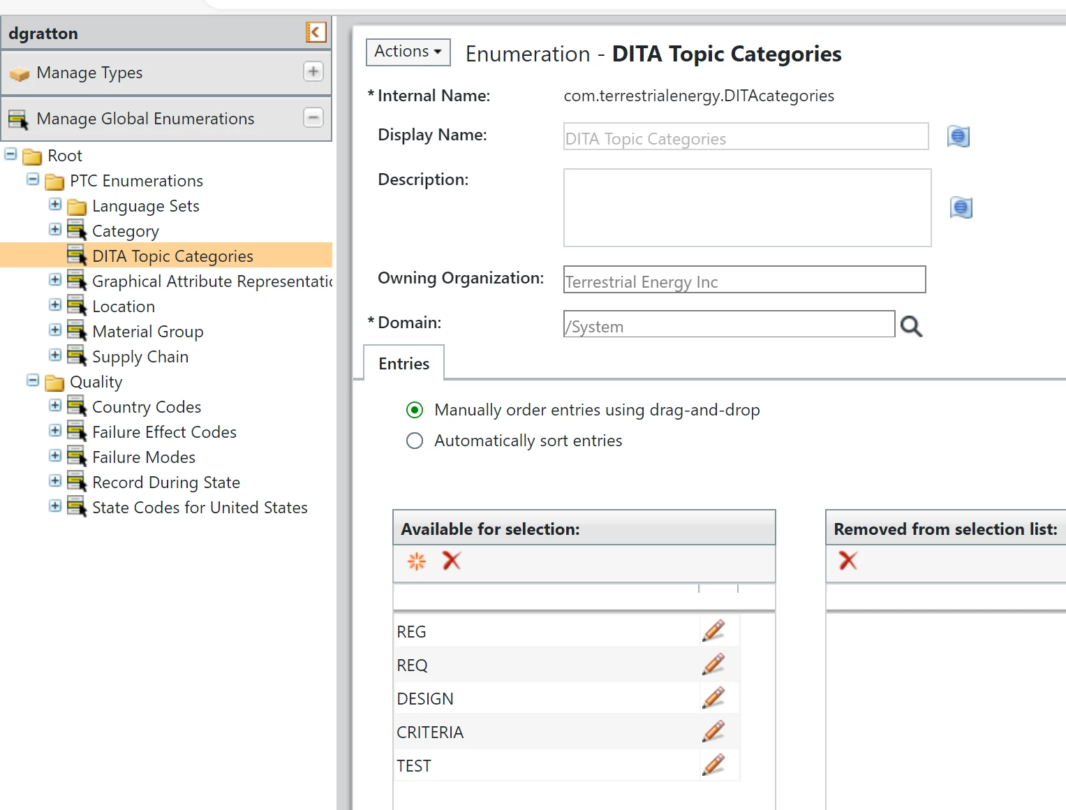

  3. I added the constraint of my DITA topic enumeration to the DITAcategory attribute.
  4. I made sure all my DITA topics had the correct category='REG".
 <prolog><metadata><category>REG</category></metadata></prolog>​
  • When I tried to load my bookmap, none of the child topics were loaded.
The error message:
Checkin Failed
Number of conflicts found:3
:Attribute com.terrestrialenergy.DITAcategory has values that violate the attribute constraints. "You must enter a value for DITA Document Category.". The values must be modified before checking in.
:Attribute com.terrestrialenergy.DITAcategory has values that violate the attribute constraints. "The value for attribute DITA Document Category must be one of the following: REG. The pre-existing value may no longer be valid for this attribute.". The values must be modified before checking in.

This is not a CAD.  DITA files are XML documents that are loaded in Windchill with the Arbortext Editor.
The constrained parameter is in the <prolog> section of the topics that are being loaded.
As I understand it, the BCF defines the mapping for these attributes to the Windchill EPM document attributes.
In this case, DITAtopic is a subtype of the EPM document.
