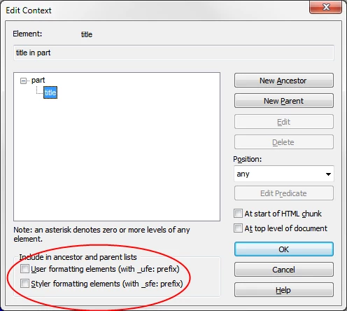

    If you are using Styler, there are checkboxes on the context dialog for
    whether you want to include UFEs and/or SFEs in the context hierarchy:
    I'm assuming that if you choose that option, and then export the
    stylesheet as FOSI, you'll get something that looks like Paul's sample.
    (This is with 6.0, M050. Not sure whether this is supported on earlier
    versions.)
    --C

    Hi Clay,
    If I check the boxes, they don't remain checked in the context I'm working in. Do you know why these would uncheck themselves?
    -Jeff
    18-Opal
    September 21, 2012
    Hi Jeff--
    As far as I can tell, it only preserves the checks that you actually
    use. In other words, if you don't specify a UFE or SFE in the context
    selection, it won't keep the corresponding box(es) checked.
    Basically, checking the box makes sure the UFE/SFE elements show up in
    the droplists that you use to add elements to the context hierarchy, for
    as long as the dialog is open.
    So I guess you'll just have to manually check the box each time you want
    to add a formatting element to the hierarchy. I don't know of a way to
    change the default behavior to make them stay checked.
    --Clay
    Clay Helberg
    Senior Consultant
    TerraXML
    September 21, 2012
    Thanks, Clay! I was able to create the proper context.
