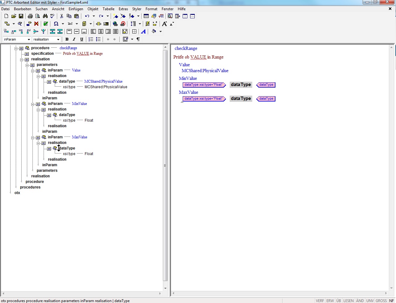

when I open my xml file FirstSample4.xml in Arbortext Editor with the stylesheet otx3.style it looks like this:
Why is the content of the attribute xsi:type displayed in the first inParam element with the name Value and isn't displayed in the elements MinValue and MaxValue?
I want the attributes of the inParam elements MinValue and MaxValue to be displayed in the same way as it is at the element Value. When I print it as a pdf all attributes are displayed.

    Hi Alessa,
    I haven't looked over the files you provided in detail, but it's possible tags are turned off, and you are only seeing a few of them due to a styling issue.
    If you use the "View" menu, there should be some options for tag display 'Full Tags', 'Partial Tags', and 'No Tags'.
    What is currently selected on your machine?
