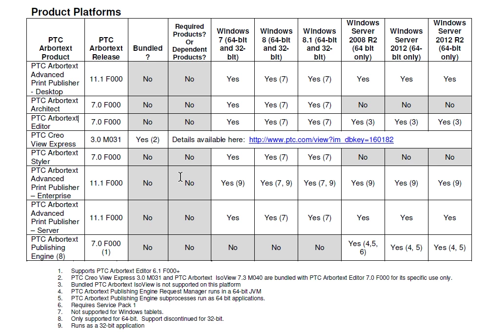

Do Arbortext editor 7.0 have support for Window 10, 64-bit version?
I've got information that Arbortext editor is supported by Window 10, 64-bit version.
But, when I look in the compatibility metrics, Window 10 is not listed. See attached image.
    Dec 3, 2017 7:54 AM UTC
    I'm not sure where you got that product matrix from, but the latest matrix clearly indicates Windows 10 support:
    https://support.ptc.com/view?im_dbkey=173524 (page 2 of 12)
    That's for Arbortext Editor 7.0 M080. From memory, I think they "officially" certified for Windows 10 in 7.0 M030?
