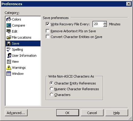

    Play with this and see what you need:
    I think there are two preferences: "Convert Character Entities on Save:" and "Write Non-ASCII Characters As:".

    Jun 3, 2011 5:09 PM UTC
    Or, in ACL-ese, "set entityoutputconvert" and "set writenonasciichar".

    Jun 3, 2011 5:13 PM UTC
    Checking both didn't seem to do what I wanted, but just Write Non-Ascii ->
    Characters did the trick.
    Thanks also for the acl, I'll add that to our startup scripts.
