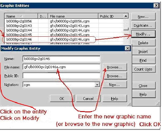

    I haven't seen the problem here since I changed the instructions on how to replace a graphic.
    Entity method (MIL-STD-38784 based DTDs). An attribute where the graphic is referenced contains the name of an entity that actually references the graphic file. e.g. <graphic boardno="entity.name" reprodep="8.25in" reprowid="7.5in" hplace="center">
    o The entity name must start with a letter and is not allowed to contain any characters except period, dash, alphabetical, and numeric characters. The underscore, space, and all other keyboard and all non-keyboard characters are specifically disallowed
    o To replace the graphic with a new graphic DO NOT change the entity name (contents of BOARDNO attribute must remain the same). Doing so causes a duplicate declaration and only the first declaration found will be effective. Instead, highlight the graphic tag, click on Entities->Graphic, and edit the file name inside the entity declaration as shown (this changes the declaration instead in inserting a new one):
    [cid:image001.png@01CD9105.39E7A9C0]
    Maybe this will help,
    -Andy
