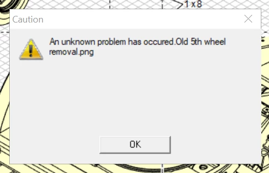

Error when export a PNG file from Arbortext IsoDraw 7.3 CADprocess
When I had my evaluation license everything worked great. But now with my new license I'm getting an error.
An unknown problem has occurred.  I only get this when exporting a PNG file no other formats.

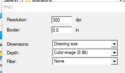

I have attached the error massage and the PNG export setting in the attachments.
Please let me know if anyone has a suggestion as to why this is happening.
Thank you

What are you using to build the image, any models, other images? I expect you are using version 7.4.3.0.
Bryon
Oct 24, 2024 7:46 PM UTC
It was created from a CATIA .STP file.
I am using Release 7.3
bfriesen
18-Opal
Oct 24, 2024 7:57 PM UTC
https://www.ptc.com/en/support/article/CS409448?source=search
Try setting the color image depth to 32 bit instead of 8 bit.
