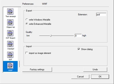

Can either computer create a correct image? Do you have a macro running the export? or do you go to file export?
In Isodraw  you can set some settings for the import export options, but it is does not look like wmf/emf have very many.
Configuration files can be found here C:\Users\username\AppData\Roaming\PTC\IsoDraw\Preferences

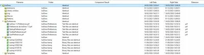

We have just reviewed that preferences screen but same configuration is applied in both computers.
Also files inside preferences folder are identical between both computers:
Is there anything else we can check?
