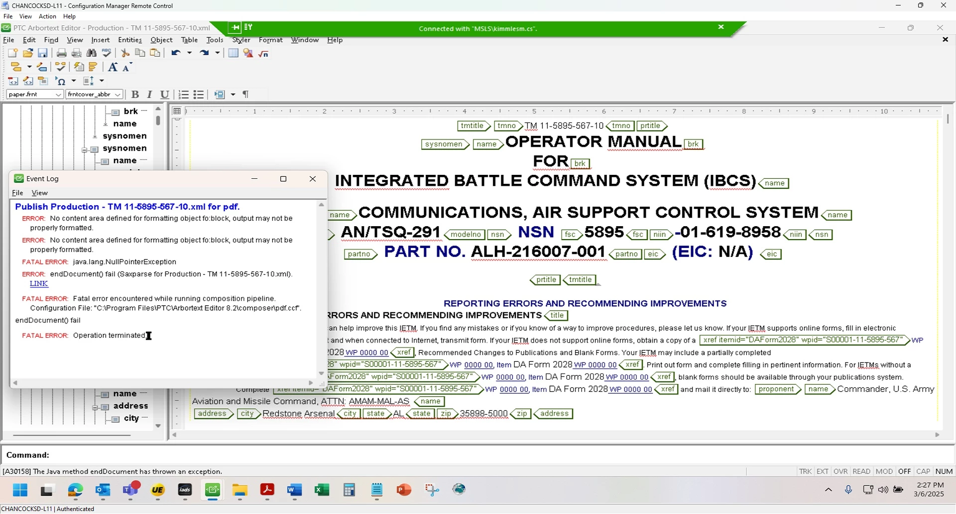

I'm supporting someone who uses Arbortext and they receive the following error message when trying to print to PDF. I have another person who has the exact same configuration without issue. I'm very unfamiliar with the software and I'm not sure where to begin.
<Heading>Publish Production 10.xml for pdf.</Heading><Record date="Thu Mar 06 14:34:57 CST 2025" millis="1741293297066" severity="error" suppress="0" thread="main">
<Level>ERROR</Level><Message>No content area defined for formatting object fo:block, output may not be properly formatted.</Message>
</Record><Record date="Thu Mar 06 14:34:57 CST 2025" millis="1741293297075" severity="error" suppress="0" thread="main">
</Record><Record date="Thu Mar 06 14:34:57 CST 2025" millis="1741293297077" severity="fatal" suppress="0" thread="main">
<Level>FATAL ERROR</Level><Message>java.lang.NullPointerException: Cannot invoke "com.arbortext.epic.saxfilter.fo.layout.Area.getAllocationWidth()" because "area" is null</Message>

7-Bedrock
Mar 11, 2025 6:57 PM UTC
The formatting was incorrect and causing the error.
Mar 8, 2025 3:08 PM UTC
Article - "Error "No content area defined for formatting object fo:block, output may not be properly formatted" and "Expecting 'fo:page-sequence' but found'fo:block' which is not a valid child of 'fo:root'" while publishing to RTF using Arbortext Editor with Styler": https://www.ptc.com/en/support/article/cs326728
Community Moderator
Mar 11, 2025 4:54 PM UTC
Hi @SK_13006266,
Anurag
SK_130062667-BedrockAuthorAnswer
7-Bedrock
