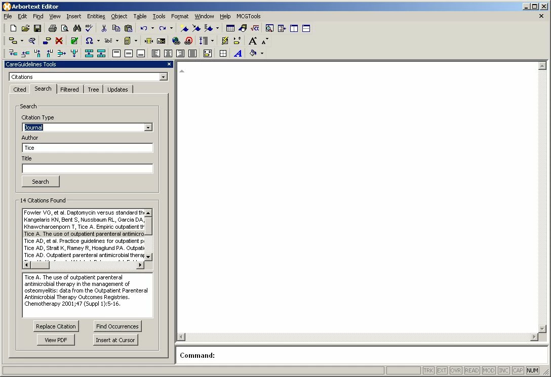

Attached is a screenshot of one of our current tools to manage citations
within a document. You can see where the number of buttons gets unwieldy
without alternatives such as right-click.
