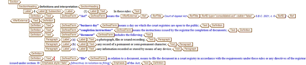

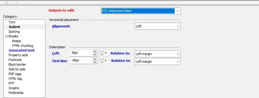

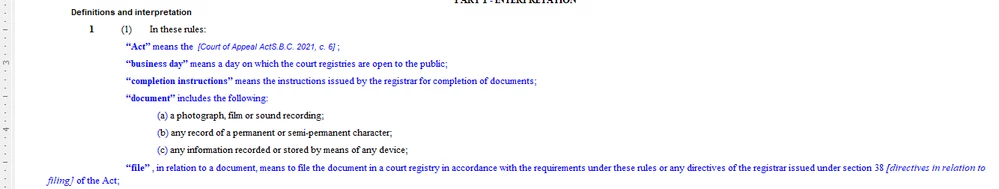

I have a text inside a definition, when this text is a large text, I am unable to shift the content to the left margin is equal to the starting line.  Inside PTC Arbortext Styler, setting indent has no effect or the undesired result.
I have attached a screenshot, you'll see "filling] of the act", that is the portion I want to show flush to "file" the previous line, in fact any long content should not be shifted to the left that way.

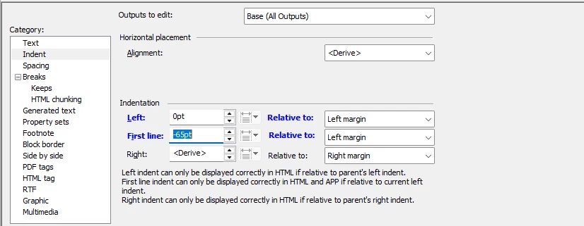

1. Text is Inline, his parent is a Block (Definition element)
2.It follows multiple XPath test conditions.
Screenshot 2025-07-29 110024.png3.I don't see any other properties overridden.

If your <Text> element is styled as inline, then you can't assign indents to it, because indenting an inline element doesn't really make sense (and Styler won't let you do it--the indent controls are grayed out for inline elements).
So are you assigning the indent values on the <Definition> element? If so, you would need to check to make sure that the rule you want for the <Definition> element is applying to this particular <Definition> element in your document, i.e. that any contexts or conditions are picking the right style definition with the desired indents.
You seem to have a custom doctype, but I did a quick test with a DITA reference topic, adding an <example> element (Block style) and a very long <ph> element (Inline style). Setting indents on the <example> element causes the expected indenting, complete with wrapping the inline element at the requested indent. So I think in your case, the <Definition> style is where you need to be troubleshooting your indent issue.
