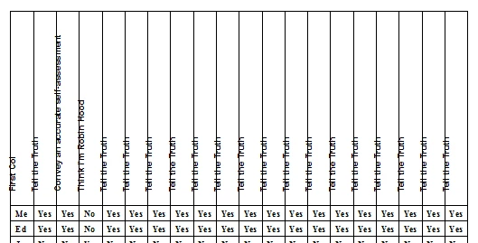

    I am experimenting with rotating the text in a table header row using FOSI. I am using the TeX code recommended in Suzanne Napoleons web page (fosiexpert.com):
    <usetext source="%\hbox{\special{pub:" rotate=" 39}%,10pt,#content,%}%&quot;="></usetext>
    I do this in an e-i-c for <entry> in the context of <thead> <e-i-c gi="entry" context="*" thead&quot;=">
    I suppress the entry contents.
    The PDF output seems to work OK, except for the fact that the rotated text runs into the text above the table and overwrites it. For long tables, when the header is repeated on every page, the table header text overwrites some of the page header and runs off the top of the page.
    I tried putting a large amount of vertical pre-space before the table. This works when there is regular text on the page above the table, but when the table is continued onto the next page, the table header text runs onto the page header and overwrites some of the page header and runs off the top of the page.
    Does anyone know of a solution for this issue?

    December 11, 2012
    Other than manually setting the row height? No, not that I'm aware of.
    That's what we used to do when using the tex "hack." Later versions of
    Arbortext support rotate (but possibly only on the 90s) so we were able to
    (maybe we still are ... as we update stylesheets using the hack) eliminate
    the row height PIs.
    December 12, 2012
    Thanks, Paul. I forgot about row height. Duh.
    Now that I have that solved, I am still having a problem with the horizontal alignment of the rotated text. I don't know enough TeX to be able to figure out how to make the rotated text appear in the center of the cell instead of clinging to the left cell border. See attached PNG.
