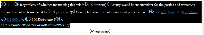

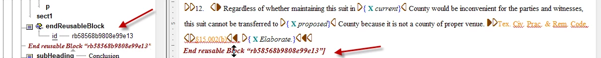

We have an empty element "endReusableBlock" that only has one attribute "id". It is styled as a block, with its text hidden and we add some gentext after it.
[cid:image002.png@01CCFB81.BB0260F0]
If we select a block that ends with the hidden element:
[cid:image003.png@01CCFB81.BB0260F0]
And use Application.ActiveDocument.getTextSelection() to get the selected text, the function doesn't return the hidden element in the range. If I change the styling of the element and make it non hidden. The function "getTextSelection()" returns is in the range.

    You should be able to control display of hidden objects using code, so
    you could do something like this:
    // return selection including hidden objects
    // NB: code not tested, debugging is left as an exercise
    var doc = Application.activeDocument;
    var hidden = doc.getOption("hidesuppressed");
    doc.setOption("hidesuppressed","off");
    var content = doc.getTextSelection;
    doc.setOption("hidesuppressed","on");
    This is javascript code, you'll need to tweak as necessary (mainly
    variable typing) if you're using Java.
    --Clay
