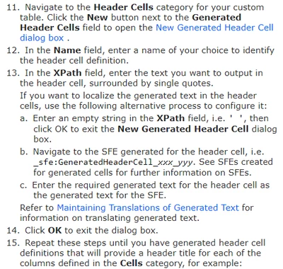

I am trying to add header cells to my custom troubleshooting table.  I am following the tutorial in Styler help:

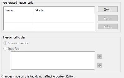

I add a name in the Name field, and 'Possible Cause' or '' (I tried both methods) in the XPath field.  When I click OK the blue circle spins a bit and the dialog closes, but there are no new cells listed in the Generated header cells field:
I checked the sfes, and nothing was added there either.
Am I doing something wrong, or does this feature not work for some reason?  We are running this on Editor/Styler 7.1. and using DITA 2.0 as our architecture.

I think you have a problem with your XPath expressions. When you ask for "/LongTitle", the slash at the beginning indicates you want it to look for that element at the root of the document, not in the current context. If you want to get the LongTitle element as a child of the current element (the Identification element if I'm reading the original post correctly), you should use "./LongTitle" (note the dot before the slash), or simply "LongTitle". So, try rewriting your Regulation expression like this:
concat(string(LongTitle), ' ', string(Id))
