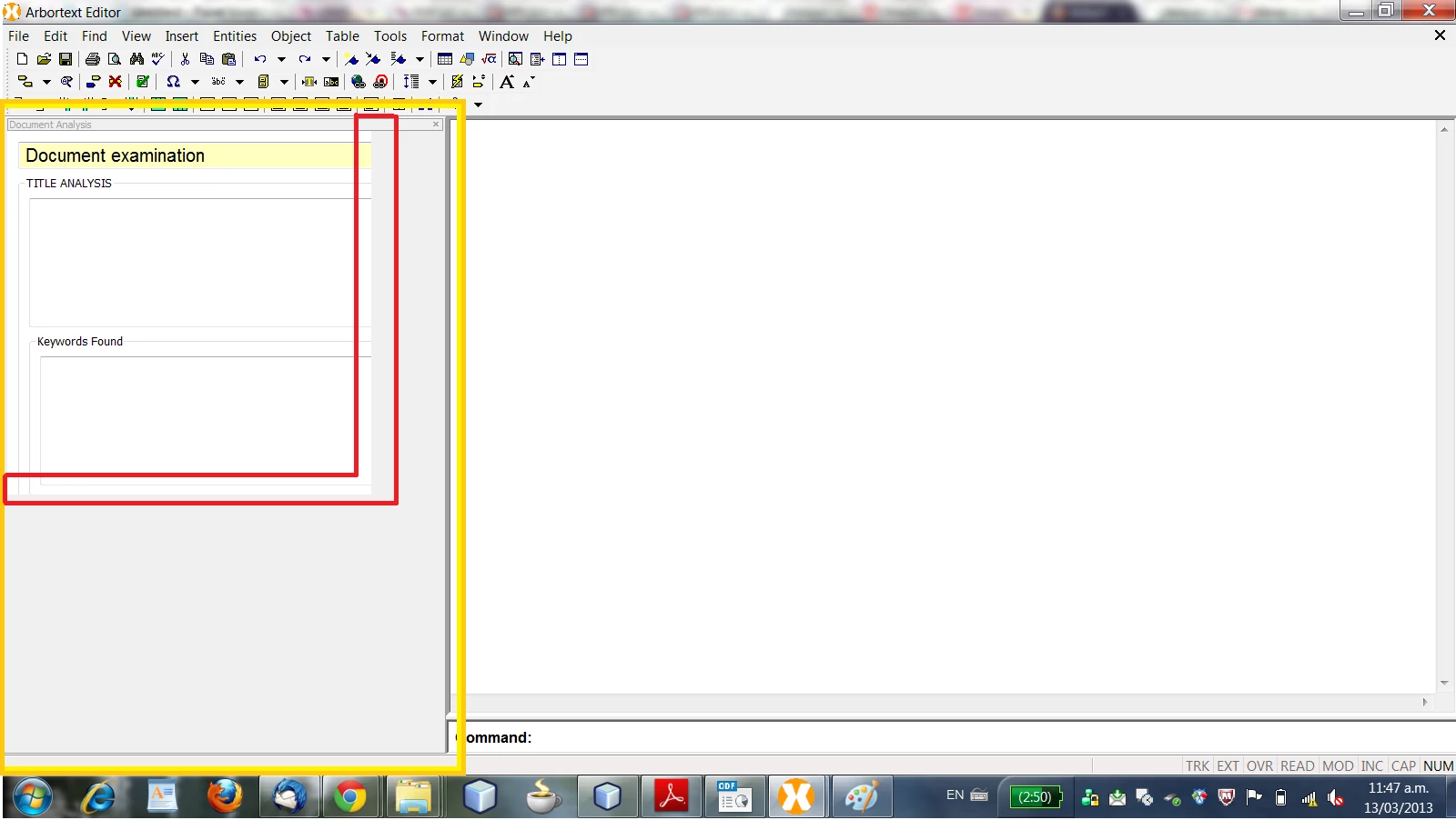

    March 13, 2013
    Hello again! 😃
    Ok, so I'm still facing the problem =( I decided to attach an image of my problem, so I think maybe you could understand better my trouble and associatte it with any issue maybe you had. Hope this image would be useful, as you can see I add a yellow square which involves my created window, then I add a red figure which encloses the border (predefined I suppose) which doesn't let me to show all my elements. Does anybody knows how can I modify this kind of predefined size or maybe there's not an option to change it and I will have to adjust my design to this size? =(
    As always I really appreciate your time and support.
    Best Regards!
    Paulette Zorrilla
    March 13, 2013
    It looks docked. What happens if you launch it un-docked? I don't do
    anything docked, so I'm not familiar with what behavior "features" it
    brings. I'm wondering if additional real estate is claimed by docking ...
    Also, I would try adding resize="both" to every element.

    pzorrilla1-VisitorAuthor
    March 14, 2013
    Paul!
    I really apreciatte your time and support, finally I've found that the tabpanel was the element which stablished the boundaries, I don't really know why, however I just decided to eliminate it, and finally I can see all my content inside my window, even if is docked.
    Again, I'm pretty grateful because of your help.
