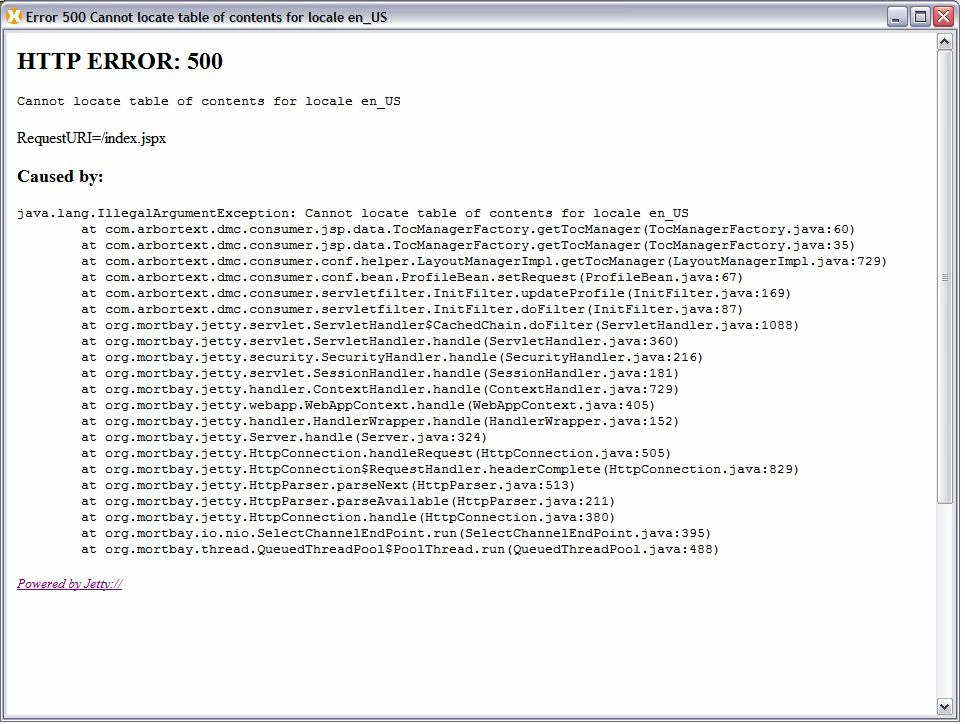

We have recently upgraded our ArborText Editor version for 5.4 to 6.0. In 6.0, when I click Help menu of the editor, it shows the attached error message. We tried all possible avenues to find the root cause of the error but we could not able to nail down this issue.

    Just reposting with smaller jpeg (it took me a while to figure out my PTC
    login, so thought it might help others)

    As I recall, during the installation, you are prompted to choose the
    language(s) for which you want help system content to be available.
    Perhaps English was mistakenly deselected? Rerunning the installer should
    provide a chance to fix this, I think.

    You could also eliminate some possible failure points by finding and
    running consumerui.jar.
    Usually located here:
    c:\program files\ptc\editor\hc\consumerui.jar
    Double-click and away you (should) go ...
