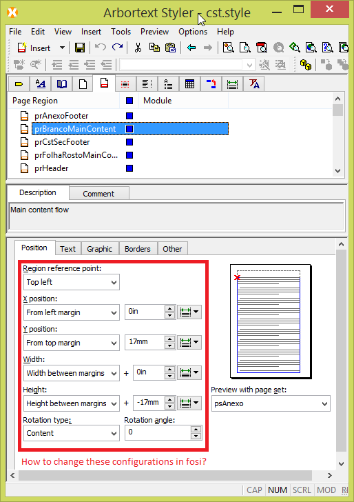

I'm having problems adjusting the main content as page region in FOSI. Where can I change in code to adjust page contents(main content)?

Your page size is determined by the PageSets tab and the page set in which your region is used.
There too is where the 4 margin sizes are defined, top, bottom, left and right.
You are correct in selecting the Page Regions tab for defining the dimensions and positioning of the body of the page.
The left edge, X position, of the region can be positioned relative to
1) the left edge of the page,
2) the right edge of the page,
3) the left margin defined in the Page Set,
4) the right margin defined in the Page Set,
5) the center of the page edges
6) the center of the page margins (this may differ from 5) if the left margin is different from the right margin
The number to the right of the above setting is an offset from the selected point of origin
The Y position is defined in a similar manner, but relative to the top and bottom page edges, margins or centers
The X & Y positions are the origin for the upper left corner of the region
Height: is where you adjust the vertical size of the region.
You can give an Absolute size, like 6.5in.
You can set the size based on the width between either the vertical or horizontal edges or margins, and then increase or decrease as needed using the number on the right.
After setting a value, click in another dropdown location to see the size adjust in the sample window on the right.

Actually what I need is to configurate the position and size of page regions, using fosi (.fos file). The images bellow explain better.
