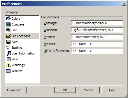

    No luck.
    The cycling through two quotes and three dashes does nothing. For entering quotes they just produce more curly quotes; for the dashes it allows two keystrokes and then ignores any further entries with dash key. Completely ignored seems to sum it up, so it's not key cycling.
    It's happening on all machines - Actually checked two Windows XPSP2 with 3 gig RAM and two Windows 7 SP1 with 4 GIG of RAM. - Same problem on all.
    Could this be a problem imposed with Office 2007? Maybe they replaced one of the common control dlls. That used to be a problem with Windows 98.
    APTCUSTOM is set to C:\CUSTOM which is where my custom directory is located.
    There are no custom applications installed - just pure SGML/FOSI. There is no %APTCUSTOM%\init directory and no %APTCUSTOM%\scripts directory.
    [cid:image001.png@01CD8A81.A2058F20]
    The Use Smart Insert Feature is unchecked. No DITA stuff installed
