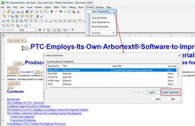

Mar 18, 2025 2:46 PM UTC
You can do this by opening the document, selecting Format->Select Stylesheets... from the menus, and clicking "Delete Association" in that dialog.
