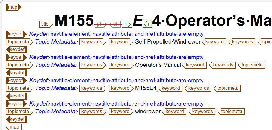

How do I get keydef to support Italics?
We have a model name that has an Italicized letter in it. How do I get the keydef to support italics?

You might need to provide an example of your problem, and why italics are not working.

The third line says M155E4, the E needs to be in italics. If I ctrl+I the letter, I get a A20294 Requested formating is not allowed in this context message at the bottom of the screen.

Hi Bryon--
I think your problem doesn't really have anything to do with keydefs, but rather it's because you're trying to insert inline formatting in a <keyword> element, where it is not allowed. You will probably either have to modify your schema, or live without italics in your keywords metadata.
--Clay
