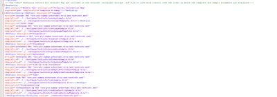

So as you will notice at the bottom, I have links to some custom dtd (docbook derivative) files. It is not included here, but I also created some dtd's based off of dita. There are a few elements and filters and such that I added to these dtd's. So I believe with this, it is possible to see the new doctype in the new document window, and this is fine.
But now I want to work with dita and dita maps. I largely prefer if the team uses the resource manager to create and insert new topics.
I have these new dita dtds in a separate folder, outside of the custom/doctypes/ folder.
However the documents listed only provide me with the out of the box dita documents, and I need to ensure they're shown the new ones instead. But I am struggling to find where I can update this list. For reference, I found the Resource Manager tab customization information on the website, but not the list within (specifically the how-to, or at least even a sample).

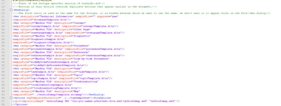

We use a zipped application that has our template files in it  So when users log into our cms the system checks to make sure each user has the latest version downloaded. We can access our templates from the file, new drop down. I did not set it up, but by the looks of things the techinfomap and techinfo dcf files were modified to show the custom files. I hope this also helps.
techinfomap
techinfo
