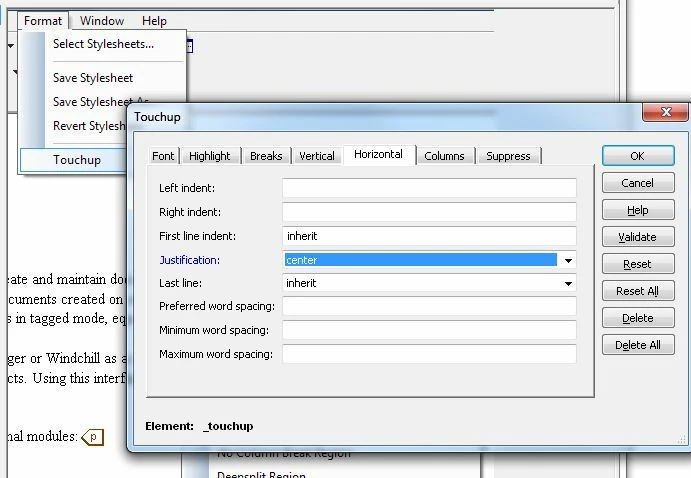

I can center text using the HTML and XHTML doctypes by editing the attributes but can't seem to do this in SGML or XML based docs like DocBook or any of our custom DTDs. It appears that it is disabled somehow but I don't know where to enable this?
I also tried to solve this by clicking on Format --> Touchup --> Custom Touchup --> Horizontal tab --> Justification = center
Does the solution involve the Styler? DTD? FOSI?
Please help, thanks!

Thanks Gareth, I realize the differences in both applications so I'm trying to find a way to do this in the FOSI and I don't know if we own the full license that includes Styler (I'll find out later today). The free version of Styler doesn't really help me, or I'm not sure how to use it because I ultimately need to make edits to PDF files.
However, what is the FORMAT --> TOUCHUP menu for if everything depends on editing a .style or FOSI? How is that option used? Do you know?
Or is there something I'm still not getting?
Jul 31, 2014 11:03 PM UTC
The free version of Styler will let you edit stylesheets for screen display only, not the PDF output. If you need to modify the PDF output then you either need Styler or need to roll your sleeves up and learn FOSI or APP code
The Touchup options insert PIs (processing instructions) in the markup. These are not elements nor attributes, but they are interpreted during the publishing process and can modify the PDF output. They are intended for minor "one off" changes to font, colour, epmhasis, etc.
