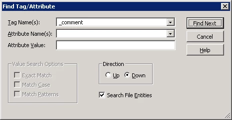

One of my users wants to search for comments. I can't see how you can do that. The user just wants to find each comment without concern for their content.
Dave
    July 28, 2010
    Find-->Tag/Attribute
    _comment
    [cid:image001.png@01CB2E53.488881A0]

    July 28, 2010
    If you do a Find/Replace and put "_comment" in the Find Within box, it
    will restrict to just comment nodes.
    keith
    July 28, 2010
    Oh, I guess I misread that... but find Tag/Entity with "_comment" as
    the tagname will also work.
    Or //comment() as an XPath if you prefer.
    keith
    July 28, 2010
    Thanks, Andy. Now I remember that "trick".
    July 28, 2010
    That is a neat trick. 🙂 I tried and found that it also works inside the Find Within: field of the Find/Replace box. I'm always making notes in comments so the ability to find obscure ones is handy. So thanks Andy!
