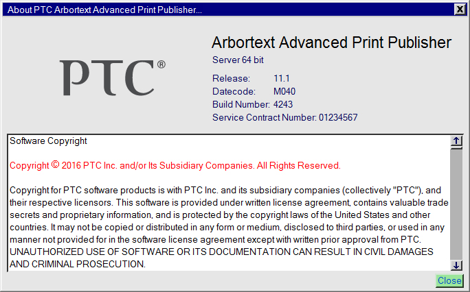

This is the version of my APP

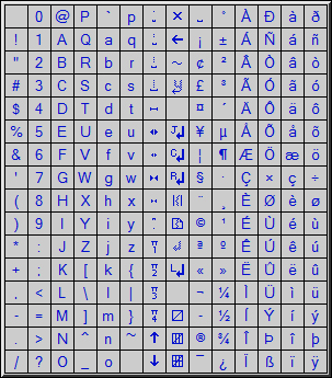

I want to convert this (Ascii Latin-1 1250 charset):

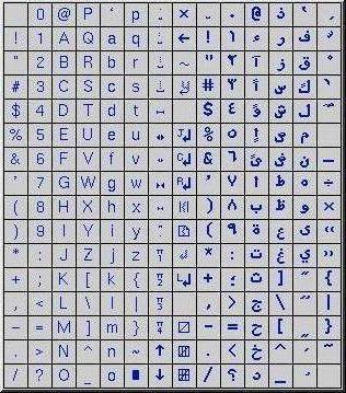

to this (Ascii Arabic 1256 charset):
In 3b2 (which was running on MS-DOS), I was able to switch between the arabic charset and Latin-1 charset using a keyboard shortcut.
I've managed to use "langkey" macro to switch between languages, but the charsets are not changing, even when I edit slukwin.3ad.
