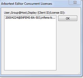

I have Arobtext editor floating lciense version 5.4, but how to check who is using the lciense. On client machine i went to Help--AE--Licenses, it lists the license users including me but im not able to scroll horizontal to find out other user. How to check the same from Server & Client machine.

On the PC where the license server is installed, you can run winquery.exe from the adeptlm license server directory.

thanks for the help..I was able to find details from server..is there any way to check details from Client machine..
June 28, 2013
Copy the aptlmusg.exe to the client PC and run it from there. I did a quick test and it only worked when APTLMHOST was referring the license server with IP, not the host name.
