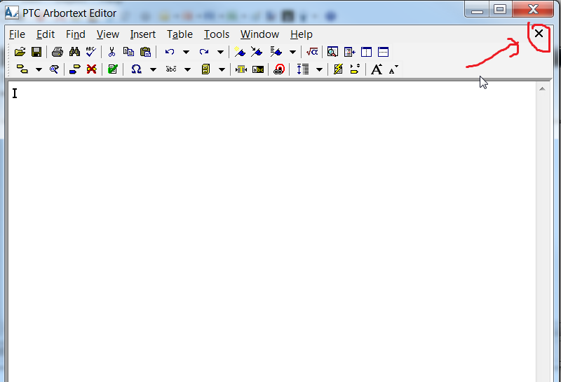

I am new to PTC Community i just started to configuration of Arbortext Editor with small tasks.
The menu_delete function is perfectly working for me on some cases but there is one more thing that i should disable also in Arbortext 6.1 Editor dialog.
How should i delete the 'X' menu item on ArborText editor, what is the menu item name of this item ?
Could you please tell me ? I couldn't find it on the reference somehow, maybe not get in deep...
Any help would be appreciated, many thanks in advance!

    One approach we used was to define a callback in our startup ACL code to manage the user's use of the X button and other quit actions
      session_add_callback('quit', 'CheckQuit', 'PREPEND');
    Where CheckQuit had the form (parameter "code" is not used)
    function  CheckQuit(code) {
        if (modified()) {
            ### Do what you need here
            set modified=off;
