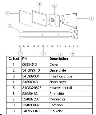

HI,
I want to add BOM table in Arbortext for a service manual. I am adding BOM table manually in the Editor. I would like to know if there is any other way to add BOM table automatically in the Editor.
