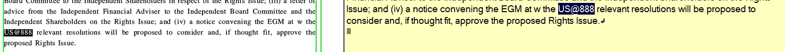

How to keep the US and $ to the same line normally?
Accordingly to the above picture, when the US$ on the last, will break the "$" to next line, but when I use other symbol, it can break to the next line together  (see the below picture)
How can I solve the problem without macro, when I typing the US$ can default keep in the same line?

If you are using the Unicode edition you can override the sunipair.3ad file using <?tunipair>. Alternatively you can stick a <?bk> and <?ek> around the affected text. APP line breaking tries to conform with Unicode (UAX #14: Unicode Line Breaking Algorithm) but sometimes doesn't quite match. The later versions of APP are much better in this regard.

Thanks Gareth,
Actually I using the latest version.
I don't want to use the <bk>and<ek>, because this situation appeared many times, so I would like to try solve it completely.
By the way, thanks for your help about the unicode tips, I can through this way to try.
