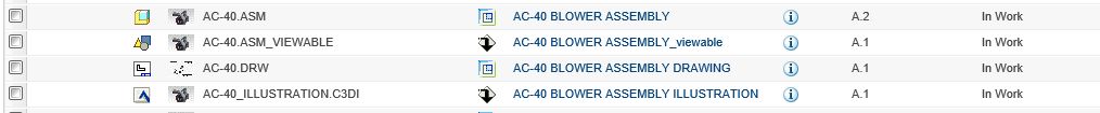

Apr 27, 2017 12:01 AM UTC
Yes, it creates a new Dynamic Document Publication Graphic that has to managed separately.    It can have it's own life cycle state and Revision.  By default, it gets created in the same folder as the source CAD document.  Here's a screenshot where you can see the original Creo assembly, the viewable, the assembly drawing and the Creo Illustrate file created using the viewable.
Windchill does create a relationship between the CAD and the Viewable, but it's not as "strong" as it could be.  If you go to the Publication Graphic and create a new tab and how the Published Content under Related Objects, it shows the CAD file that it came from.  The problem is, that if you go to rename the source CAD file, the Publication Graphic doesn't get selected and I've not seen any way to have it come up via the relationships.  the only way I've been able to work out is to relate the Graphic to the WTPart and then you can find it.
