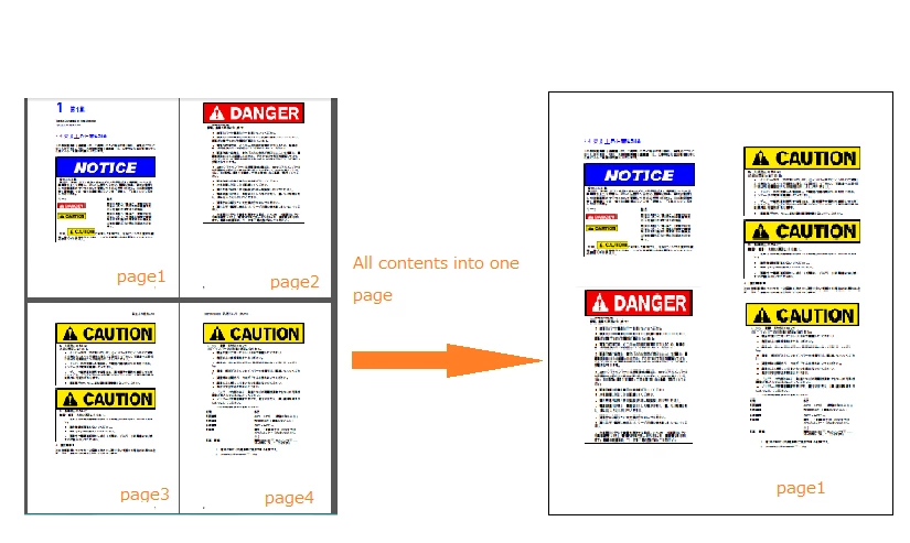

I would like to know the way in Arbortext Styler how to put elements into one page.
I made 8 element contents all with "hazardstatement" in Arbortext Editor and when its published in PDF, each hazardstatement shows up on different pages. (In total, 8 pages of hazardstatements with a lot of unnecessary blank space.)
All those 8 element contents in one same page to show it concisely with a stylesheet.
I hope to hear your advice.
