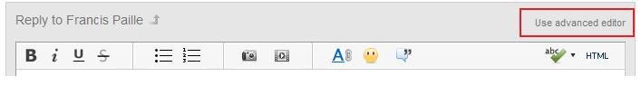

    Hello!
    To attach a file to the message, use the option "Use advanced editor".
