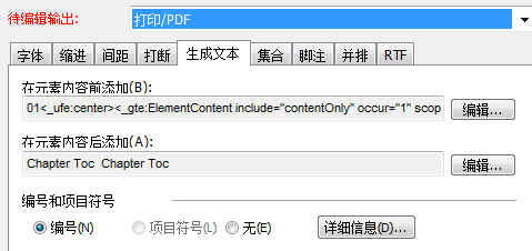

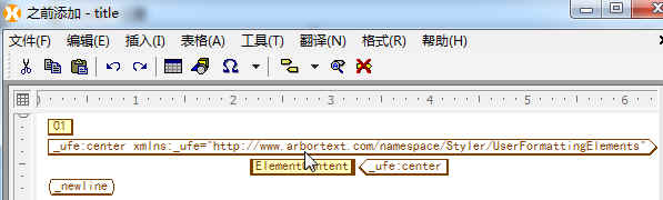

Have you looked at the styling of the title element in the context of a chapter, looking particularly at the Generate Text numbering?
//I find these, but I'm not sure about it, I'm confused for it
