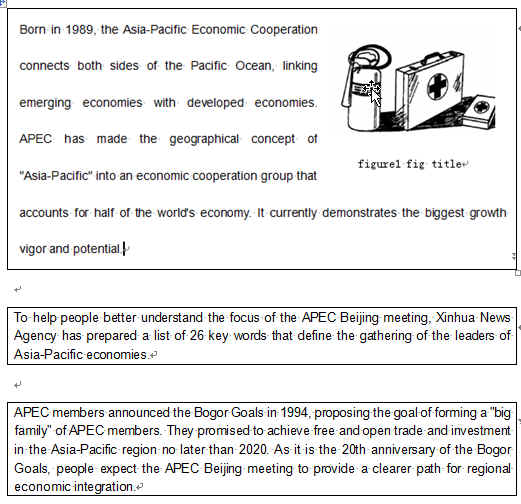

Dear all,
How to set up the paragraph inside borders?
Nearly every paragraphs, and each paragraph may have many different images...
for example:
the only method I think is add a table...
but when you add a table, maybe there are many restriction for the edit and the style control.
Your assistance will be highly appreciated in this regard.
Thanking you
Lorin
Best answer by GarethOakes
Styler does not have boxing support. I understand that feature may be coming in a future release. Right now you have to used edited source to add the borders (boxing). For FOSI there is a simple method to edit the source and add a <boxing> element. For APP you can either use paragraph rules, or add a block around each paragraph. Either way you will need to know edited source and be able to apply it to all elements/contexts that require boxing. It is recommended to use a Styler property set for the boxing overrides.
BTW while I think you could make borders by adding tables everywhere that will no doubt cause a drastic slow-down and a lot of other issues and side effects.

Thank you Gareth, I'm now strating for the style and CMS, and didn't have a systemic study...
I'm sure your reply gave me a forward direction, thanks again!!!
