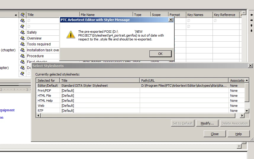

I have a stylesheet developed for Styler 6.0 when i try to use this stylesheet in 6.1 and to publish pdf output the graphics started overlaping and Showing Event Log Error =>
<Level>ERROR</Level><Message>Pg 4 All Table Columns too narrow to
fit text - exit table [1201] (3:"_s_h_o_w_4_"#350) (2:"stylesheet0:Element:image:image_everywhere_else:onEnter"#2087)
(1:"editorDom0"#{0;/RDStyle/ResolvedMap/bookmap/chapter[2]/body/section/fig/image/alt})
It also shows an error => the pre exported FOSI is out of date and should be re exported.
Screen shot attached .How to update the 6.0 stylesheet for 6.1.

I wil ltake a guess at it and it sounds line you will need to open the stylesheet in styler, then export your stylesheet as a fosi. You will then rename it to .genfos and save it in the same location as the style sheet.

Hi thanks for the reply,
I have already tried that option even then it shows the same error. Can you please tell me some alternate method to resolve this issue. It will be a great help.

Have you had any progress on this issue? Does modifying the table in question (styled in context image:image_everywhere_else) help any?
Mar 5, 2015 5:45 PM UTC
Rajendra,
Where did you place a4_portrait.genfos after exporting a4_portrait.fos and renaming it?
It should be placed in the same directory as the style sheet.
Did you have any FOSI source edits in you 6.0 stylesheets?

Hi Phelps,
i placed genfos file in same stylesheet directory. I dont have FOSI source edits, but i have one APP_template.3f file using in optional APP template to associate with stylesheet.
