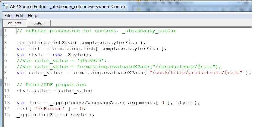

Hello, I want to use _ufe element with universal definition of the colour.
The actual colour will be set in the xml document, e.g. in the <productname> element and his "role" attribute.
I changed the APP source for _ufe by this way:
//var color_value = '#0c6979';
var color_value = formating.evaluateXPath("//productname/@role");
// Print/PDF properties
style.color = ( color_value )
but it doesnť work. Maybe the formating.evaluateXPath function doesn't return a string value?
The attempt with the direct setting of the color (a commented row) works OK.
Thanks for help
Jana

Hi Gareth, thanks for your tip,  I checked the expression and it returns correct value (e.g. in generated text). But whenever I use it in the APP source edit it doesn't work. The colour of the text is stil in black or it doesn't appear at all.
Jana

Hello, I found the different behaviour - whenever I use this _ufe element (with xpath expression) in the common text it works correctly.
But when I use this same _ufe element  in the "Generated Contents" in the Page Region (and it is area when I need it 🙂 it doesn't work at all.
Do you have any idea how to solve it?  Sorry I'm not very skill in FOM/DOM syntaxe ...
Thanks  Jana

I haven't done this for a while, but there always used to be problems with XPath in generated content. Essentially the XPath couldn't properly "see" the document tree when running inside the generated content.
There are a couple of solutions:
  1. Store the colour value in a variable and use it later on
  2. Try prepending xml0# to the XPath
For #1, you would have to add a source edit in the root element to save the colour value. e.g. application.variables.myColour = formatting.evaluteXPath("/my/xpath"); Then you can use application.variables.myColour in your generated content source edit.
For #2, we're trying to trick APP to "see" the correct XML stream. The in-memory APP document will have a number of streams (headers, footers, and main text). The main text used to be called "xml0" hence the special syntax to direct the XPath to the correct location. e.g. formatting.evaluateXPath("xml0#/my/xpath");
