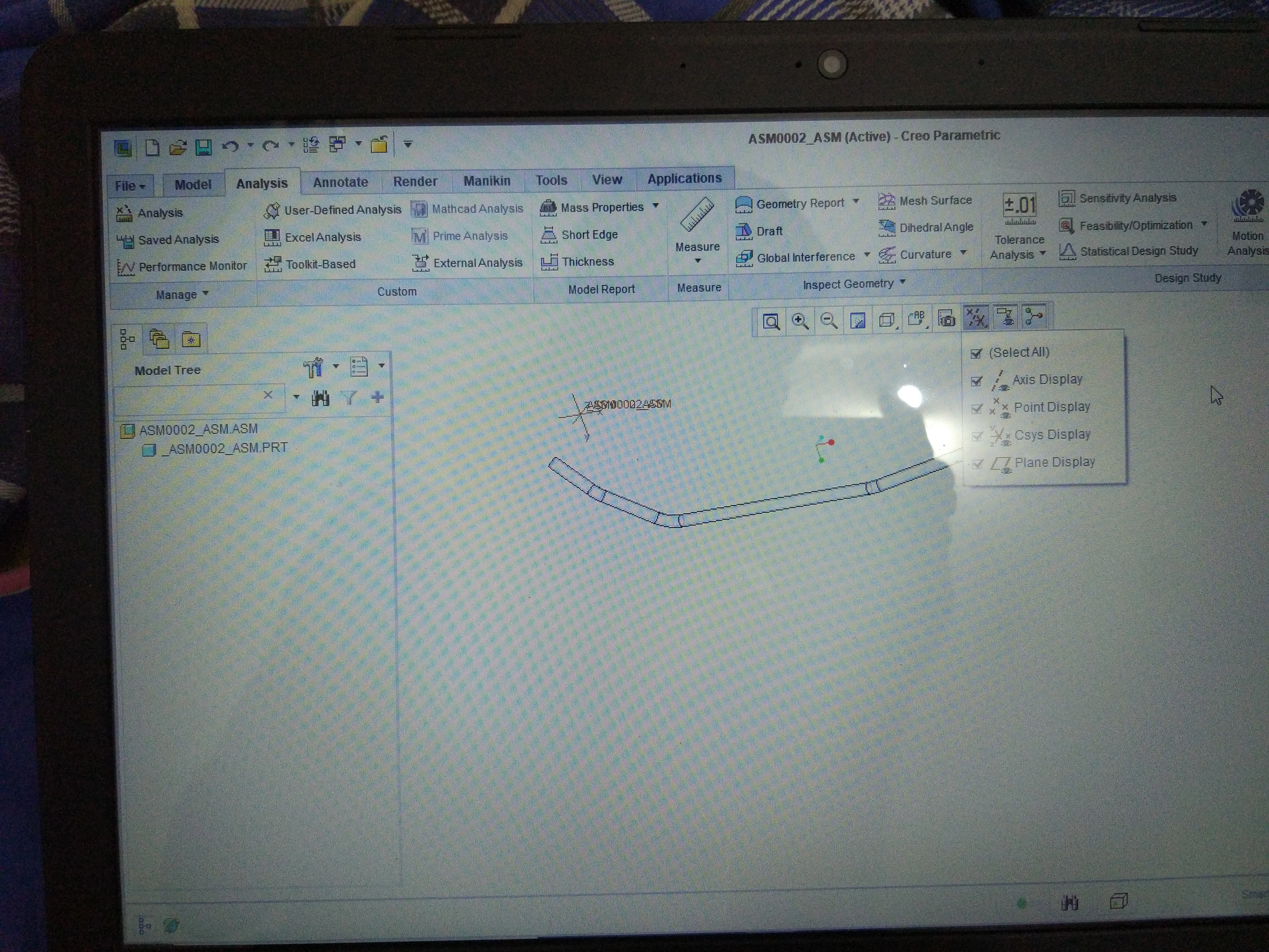

Jun 16, 2018 7:16 PM UTC
How to edit these types of drawings can't view the plances
