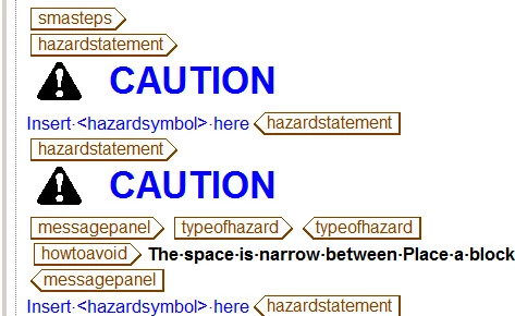

inserting a hazardstatement in AE 6.1 F000
We have recently (corrected) been testing Arbortext 6.1. My question is when I used to insert a hazardsatement it would come with an assortment of tags inside it messagepanel, typeofhazard, howtoavaoid. In this new version it does not seem to add them to the hazardstatement tag. Where do I look to correct this behavior, is this a setting I can find in styler to define what tags are included with an element?

    Hi Bryon--
    Check your preferences, and make sure "Insert Required Elements" on the Edit panel is selected.
    --Clay

    That worked, thank you Clay, your knowledge is much appreciated.
    Bryon
