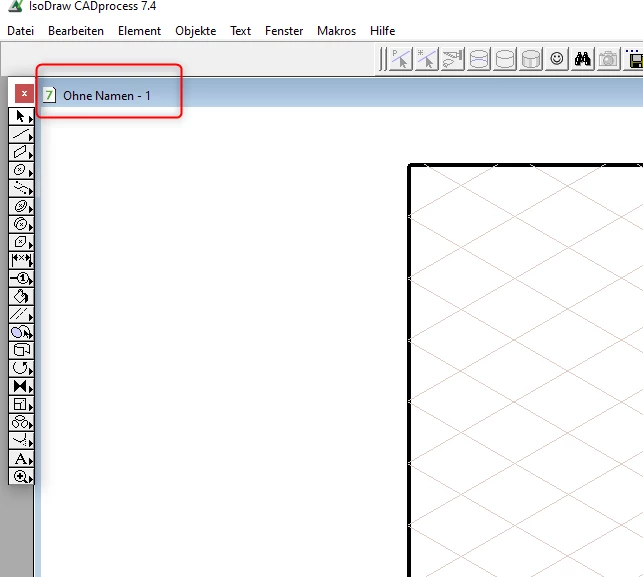

Hello everyone.
Is there any way to change the template file to my own template when opening IsoDraw?
Thank you for your help.

18-Opal
April 3, 2025
You can create template files following the instruction link that  provided. Once you save them in the template folder. They will be available from the file, new menu. I have asked before and there is no way for it to open your template file as the default. That would be nice.
Also you can now copy these templates to other users and have them use the same template files. It would also be nice if the template files could be stored in a referenced network location like the macros.
