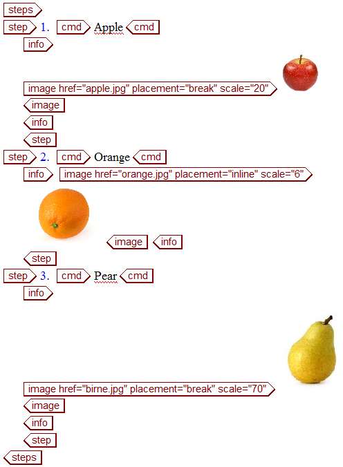

    I created a new example with the same structure you have:
    In Styler set the step to hidden
    For steps, create a new context where you have to specify the number of children
    With this context you can use the Gentext after to display the cmd elements. The image shows how to use the first cmd element. Do it the same way for the second and for the third.
    The same approach works then for the images
    In total we need 6 elements added to the gentext: 3 for the cmd element, 3 for the images
    This is my outpout:
    It's not a perfect solution because you have to create several instances of your steps element, covering all numbers of children.

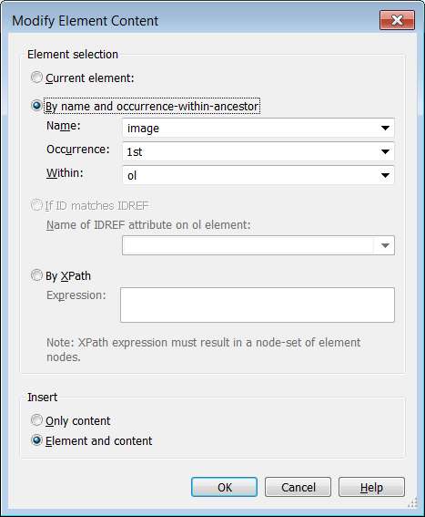

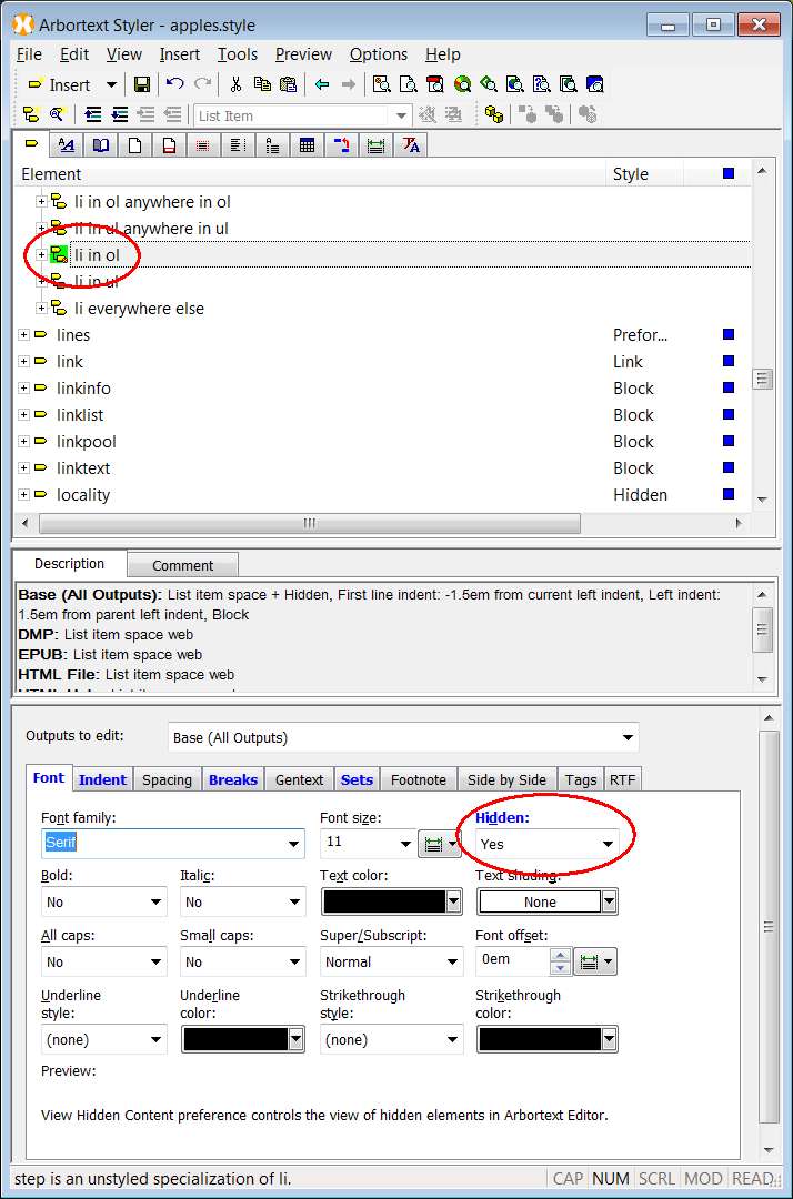

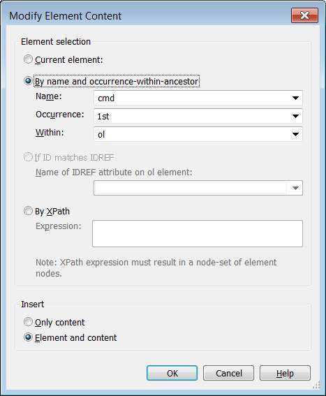

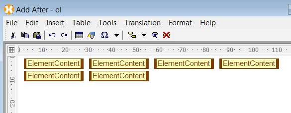

    This is my outpout:
