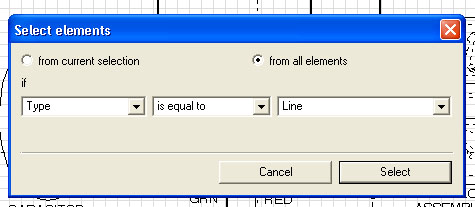

Is there a hot key for "select element" window?
My question is simple. Is there a hot or quick key combination for "select element" window? I use it a lot and it seems ridiculous to have to navigate to the menu bar everytime I want to use it. Any info on this would be greatly appreciated! Thanks!select_element.jpg

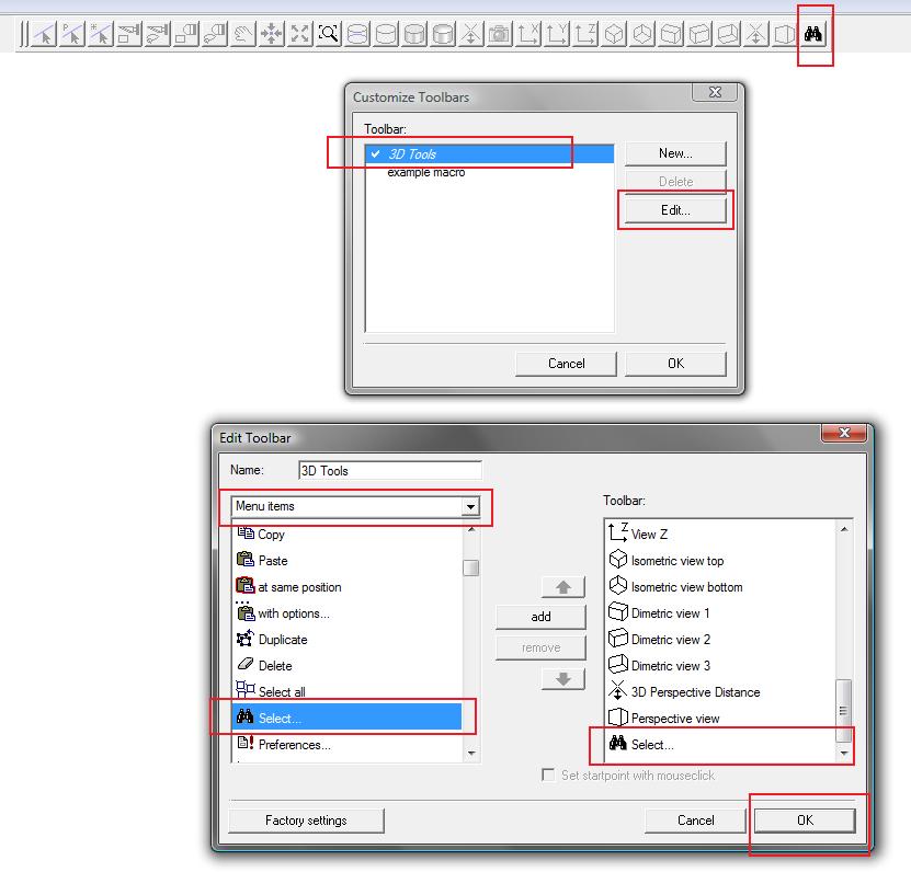

    Hello!
    You can add this command in a working toolbar (for faster access):
    Also, a list of keyboard shortcuts in IsoDraw can be found here (but "select element" is not listed): http://communities.ptc.com/message/149043

    Jul 5, 2011 10:35 PM UTC
    Thank you! The toolbar button is helpful but I still wish there were a keyboard shortcut for it! Oh well. I am using IsoDraw 7.0
