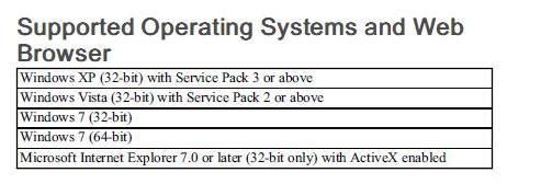

IsoDraw 6.2 / 7.x under "Windows 7 64bit"
Is it possible to work with IsoDraw 6.2 or 7.x on "Windows 7 64bit"?
Mar 11, 2011 8:56 AM UTC
I have tested IsoDraw 7.x under Windows 7 64Bit fine.
IsoDraw 6.2 will not run on Windows 7 64Bit, I had issues with the USB dongle but a driver update resolved that, however IsoDraw will not run. Error finding hardware dongle. I've trawled the net but found nothing.
Jawa29
Mar 11, 2011 12:28 PM UTC
Only Arbortext Isodraw 7.1 is supported for Win7 64bit - more information you casn find:
Platform Support Arbortext IsoDraw 7.1
and
Platform Support Arbortext IsoDraw 7.0
